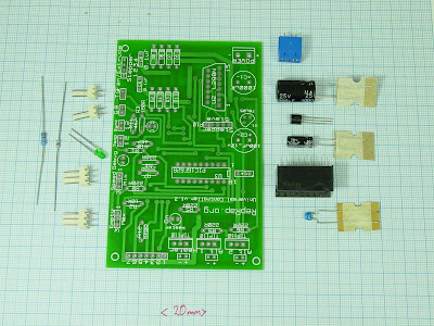

Soldering - first stage: power, PIC holder, communications and LED
Here is a mise en place for the first stage of making the universal board:
Order of Assembly
  1. 18-pin DIL socket - if your holder has a dimple, match it up with the notch on the silkscreen
  2. U1, 78L05 regulator- match up flat side with silkscreen
  3. C1 (1000uF) - polarity on silkscreen
  4. C2 (100uF) - polarity on silkscreen
  5. Debug LED - the anode (+) is the longer of the two leads and goes in the square pad.
  6. R2 (10K), R4 (220R), C4 (0.1uF) - the orientation doesn't matter.
  7. Double screw terminal for power - make sure to put the openings for the wire facing the outside
  8. Version 1.2.0: GR and TG 2-pin headers. TG: tab facing inside. GR: tab facing outside
  9. Version 1.2.1: Rx and Tx 2-pin headers. Both tabs facing inside
  10. "max" and "min" 3-pin connectors, the tab goes to the inside
  11. R7 and R8 - fit shorting wire links.
R7 and R8 allow the use of non-standard opto-switches and are usually not needed; replace them with wire jumpers. These can be conveniently obtained when trimming R2 or R4.
The PIC will eventually be mounted in the 18-pin DIL socket, as it will need to be removed and re-inserted for programming. Don't worry if you can't get the high-profile sockets used in the photos; ordinary 18-pin sockets will do just fine. Leave the PIC in its anti-static packaging for the moment.
Use a couple of jumpers to short the left-hand pairs of pins of "Max" and "Min", as in the picture. In a stepper controller these connect the end-stop sensors, and shorting the middle pins to ground is the signal the the carriage is not at the endstop. In an extruder they are used to log the extrude speed and to check for the exhaustion of the material being extruded.
